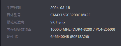

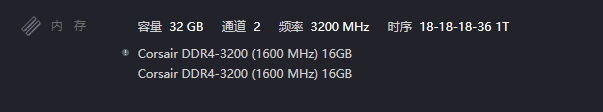

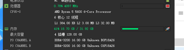

发表于 2026-1-5 17:52:17 | 只看该作者
目前有一个问题,我的内存用您的程序打开无法显示出内存的品牌,但是游戏加加可以显示海盗船的英文品牌
截图有三张:
代码调用如下
nwinfo.exe" --smbios=17
NWinfo:
    Build Time: 'Jan  5 2026 02:06:42'
    libnw: 'v1.5.4.0'
    MSVC Version: '194435222'
    NT Version: '10.0.22631'
    Driver: 'NOT FOUND'
    Language ID: '2052'
    libcpuid: '0.8.1'
    CrystalDiskInfo: '9.7.2'
    PCI ID: '2026.01.03'
    USB ID: '2025.09.15'
    PNP ID: '2026.01.05'
    JEP106 ID: '2025.06.12'
    Error: [  ]
    SMBIOS:
        - DMI:
            SMBIOS Version: '2.8'
            DMI Reversion: 0
            SMBIOS Length: 2611
        - Table:
            Table Type: 17
            Table Length: 40
            Table Handle: 25
            Description: 'Memory Device'
        - Table:
            Table Type: 17
            Table Length: 40
            Table Handle: 27
            Physical Memory Array Handle: 17
            Memory Error Information Handle: 26
            Total Width (bits): 64
            Data Width (bits): 64
            Device Size: 17179869184
            Form Factor: 'DIMM'
            Device Set: 0
            Device Locator: 'DIMM 1'
            Bank Locator: 'P0 CHANNEL A'
            Device Type: 'DDR4'
            Type Detail: 16512
            Speed (MT/s): 3200
            Manufacturer: 'Unknown'
            Serial Number: 'B0F18A26'
            Asset Tag Number: 'NULL'
            Part Number: 'CM4X16GC3200C16K2E  '
            Attributes: 1
            Configured Speed (MT/s): 3200
            Minimum Voltage (mV): 1200
            Maximum Voltage (mV): 1200
            Configured Voltage (mV): 1200
        - Table:
            Table Type: 17
            Table Length: 40
            Table Handle: 30
        - Table:
            Table Type: 17
            Table Length: 40
            Table Handle: 32
            Memory Error Information Handle: 31
            Form Factor: 'DIMM'
            Device Set: 0
            Bank Locator: 'P0 CHANNEL B'
            Device Type: 'DDR4'
            Type Detail: 16512
            Speed (MT/s): 3200
            Serial Number: 'C6F18A26'
            Attributes: 1
执行nwinfo.exe --spd看看 这个命令有风险,后果自负。  详情 回复 发表于 2026-1-5 18:19
这个命令有风险,后果自负。
